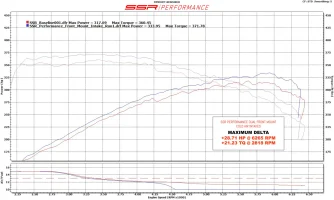

SSR had very similar dyno results from just intakes. 29whp & 21wtq max gains.

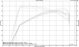

Tork gained 44wtq@6100rpm max on a Stock Stinger from just intakes. He also gained 28whp peak & 50whp@6100rpm from both intakes & muffler deletes.
