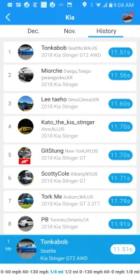

New commer to the dragy leader boards at #3 with a big turbo car out of Korea.
60-130 in the 8s.
126mph isn't bad but sort of similar to what FFP ran with their Pure Hybrid turbos. Hopefully there is a lot faster traps to come.
Xot1 our resident Korean racing expert shared this big turbo car is AWD and hits boost around 3500-4000 RPM. Its 620 HP!
