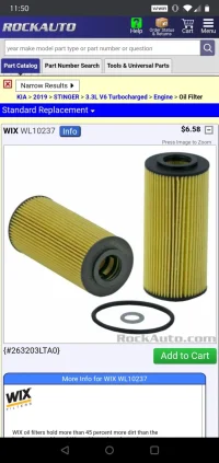

What oil filter can I use? Does it have to be the OEM oil filter from the dealership, or is there a cheaper better filter I can use?
I’d use the oem filter, saves any drama with the dealer when you get it serviced and they pull out another brand.
WIX has a replacement filter for our cars. Inexpensive. Even made in Korea. PN - WL10237
Superior to OEM, in my opinion, due to composite ends instead of the paper/cardboard based frame.
