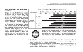

So take your pick based on your temperature range of driving, desired MPG, style of driving (high reving RPM in the hottest conditions vs casual city driving in the cold)

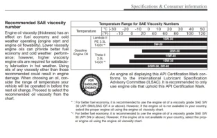

Just read through the manual for my '19 GT1 (just picked it up today), and for the Theta 3.3, they removed everything except 5w30 and 10w30...
Yep you are right, a few weeks ago the canadian manual said 5w40 for the 3.3 as well, now just 5w-30,
anyone with a 2019 printed manual?
yet the 2018 still have this..
Hmmm wonder why 0w30 cannot be used for 3.3t?
