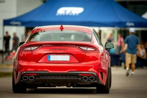

We're "lucky" that we didn't get one that is misaligned. But that means that most Stinger owners are "lucky". Here's a random Yellow, since we're posting them as evidence:

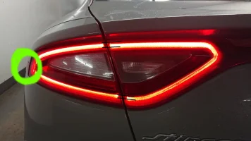

Hmmm, just checked mine and a friend of mine Stinger. Both dont have the misaligned, but i discover some conspicuity on your posted pic See pic1. Made a green ring around it.

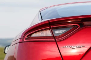

This part should be in line with the cars body, so it is at mine and friends car. See pic2 Yours looks like standing out. Thats not how it should be.upload_2019-11-5_10-37-34.webp 2018-Kia-Stinger-GT-taillight.webp 4a.webp
This part should be in line with the cars body, so it is at mine and friends car. See pic2 Yours looks like standing out. Thats not how it should be.View attachment 36964 View attachment 36965 View attachment 36966
