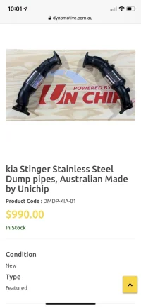

Any one had any experience using the Unichip dump pipes? They are using 100 cell cats.

I was going to say $990 woah but then it's in Aussie roos. I wonder about the weld quality. They claim any gains?
I’m not sure in relation to HP gains but they have been recommended to me by a local dyno tuner as part of a unichip package. I was more concerned if they would create any problems with the turbo seals leakage that was mentioned in this post ?
Honestly you money is probably better spent elsewhere. The gains are minimal at best, oil might not leak but why risk it, if you strip a stud your buying a new turbo (1k US) and they are also a pain to remove. So as far as exhaust work goes it's catback- midpipes-------------------------------------downpipes.
