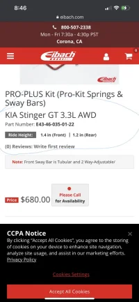

Good luck getting the Pro Plus Eibach package. I talked to them today and they are on back order until May. I called a few other places and they are out, even K8 sold their last one on 2/22. I ended up ordering through Tire Rack who has a deal (when they come in) for $578 with free shipping on this package that normally costs $680 everywhere else.
Figures when I’m ready to pull the trigger on them they’d be on back order. I’ll check out Tire Rack though. Thanks for the info!

So I went to tire rack and ordered the Eibach front and rear sway bars and Eibach lowering springs (separately). I didn’t see the pro kit on their website. But it came out to $662. I think the AWD version is a little more expensive.
Still cheaper than $680. The good news is you will get the Sway bars right away. The back order was based on front springs I believe.
I decided to cancel my separate orders and go with the kit like you did. Mainly because I’ll save $100 and can use that towards the ATQ subframe chassis collar kit. Since those are also on back order and I prefer to do add all these things at one time so the urgency took a back seat. Thank you for sending that link and saving me $100!!! I really appreciate it!!!
