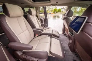

19 Sedona is going to be sweet in this configuration.
Wow, reclining seats and is that dual sunroofs I'm seeing?
