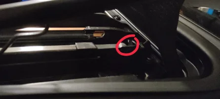

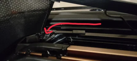

Another update - silicone lubricant eliminated most of the noise, but I was still getting a ticking noise from the sunroof sometimes over small bumps.
Credit to Hein on one of the FB groups for this idea and the photos. This eliminated the ticking noise for me.
A metal protrusion underneath the sunroof glass rests in the pictured trough when closed.
When I pressed either front corner of the glass when the sunroof was closed, the noise could be heard.
Hein taped the upper metal piece below the glass, but that was too difficult for me to reach. I put foam tape inside of the trough to eliminate the noise after cleaning up the large amount of grease inside.
I don't think the foam tape will stay in place with repeated opening/closing, so I plan to use a thin fabric tape in the future instead of foam. I'll try either the sticky part of a fabric bandage or some bowler's tape.
