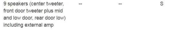

The website is unclear. The user on this post Oxide365 indicated this. The website says the front door speakers are 3 ways however you can see from the pictures that this is false. If the front doors only have 2 speakers then where are the other 2? Subs makes the most sense and oxide365 actually has the car :)

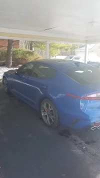

Then you don't have the base factory unit in the GT with the so called 9 speaker's I just took it to the top Car Audio shop in Indianapolis and he tested it in the shop and all thats under the seat in the base unit GT is grates and wholes!!! no subs present

What I can't understand is where does 9 come in if the subs are not present? The pics on Kia's website show 2 speakers in the front doors while the description says 3 per door. This would account for the extra 2 speakers. To those that do not have the subs under the seats, do you have 3 speakers or 2 per door in the front?
ok so just got off the phone eith the service director at my dealership he is a personal friend we used to work together
Base audio unit GT model 9 speakers
1 center
3 front door x2
