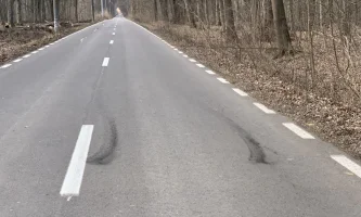

Tried to get my (loan) GT to do a burnout. Tried turning off traction then also ESC, sport mode, manual shift to 1, floor it and it still doesn't spin then. Like it's actually giving it part throttle then a few milliseconds later it gives it full throttle.
This has got to be the computer getting in the way and stopping the fun...?
Tried a little bit of brake and mashing the throttle and of course that just initiated launch control.
It did break loose once when taking off turning rights at some lights but I really want to spin the tyres in a straight line.
