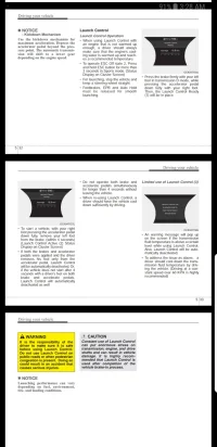

Tried a little bit of brake and mashing the throttle and of course that just initiated launch control.
