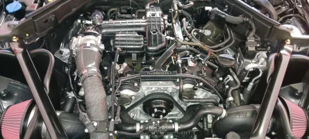

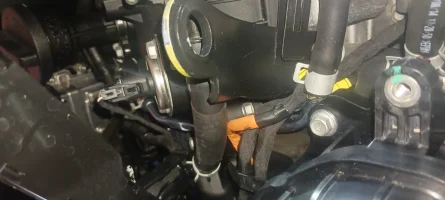

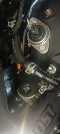

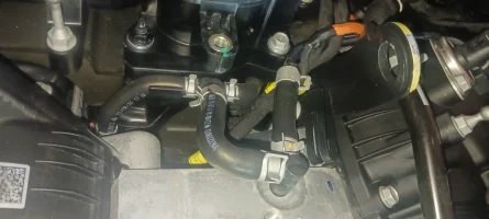

Thinking about doing this during my next batch of maintenance. Here's a picture of the lines in question for any curious -- you could either remove the hoses in light blue and cap the barbs on the hard line, or route the longer left hose to the right barb (assuming it's long enough and doesn't kink from a tight radius), or connect the two hoses with a barb fitting.

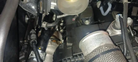

But I also have a question: does anyone know what the light blue line in the second picture is for? Picture is taken from the driver's side of the car facing the passenger side.
hmm maybe can it be bypassed as well?
The blue line in the second picture is the “coolant return” or the low pressure “hot side” of the coolant system.
In the genesis coupes we do the coolant bypass aswell. We did not cap off the lines but connected the feed and return directly. The hose on those cars was long enough to loop directly. In these cars idk. I also don’t think it’s necessary anymore because “IAT sensor relocation kit” solves the manifold heat soak issues.
Iv seen very good gains on my genesis coupe anyway. But that thing is modded to hell and back.
Thank you, but where is it returning from? I couldn't see where the side opposite the big coolant pipe connects, is it in the block valley or heads?
It joins to the T section above the Waterpump where we burp air out of the coolant system...

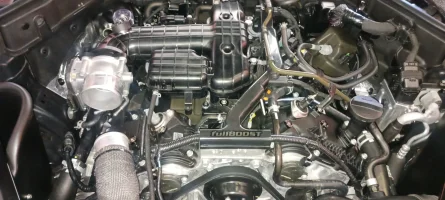

I only took 5min's to remove everything to show you, cheers.
Might as well remove my manifold and check my plugs while I am in here...
Thank you! So no additional under-manifold circuit that would be worth bypassing then, besides the TB...
