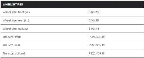

The AWD square 18" rims come with A/S tires and has a limited top speed of 130 mph. The AWD staggered 19" rims are 8.5" in the front and 9" in the rear; come with Michelin Pilot Sport tires, and the speed limiter is the vaunted 167 mph. Other than that difference, I don't think that square vs staggered produces any difference other than visual subtleties.
Point of clarification...the stock 19" wheels are 8 and 8.5, not 8.5 and 9. Per Kia (and other sources). Which is why I'm more or less stuck with 255s until I spend pots of cash to change wheels. Not much in the way of wider options that will satisfy the requirement to stay close to 26" total diameter without a rim swap.
Sad, but true. There are no viable options to upsize tire width on the stock wheels.
