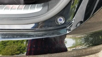

So far mine is quiet. On occasion I hear a tiny rattle over rough roads but I have to listen for it. Not sure if it's the hatch but just added rubber washers to the plastic bumper things today as a precaution.
Its a couple dollar fix. I also used these Vinyl round bumpers that I stuck on the car where the overslam bumper comes in contact.View attachment 60122

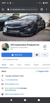

Anyone have an e-mail adress to ATQ as I dont have Facebook or a working Messenger. I want to order these subframecollars. Or if any will e-mail me at: mikael.aman@minmail.onmicrosoft.com
I would be willing to help out if you wanted to send me the money, and I will order them. Price is $243US shipped to me. Then I would have to add shipping to you. Let me know
