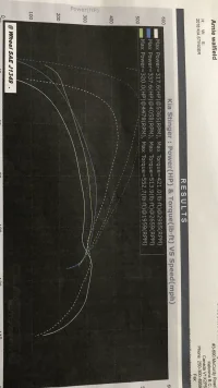

    Wow my car really runs very much slower ,so your 99 octane works very well better than what I have and mine was also on a DYNO Com

    Here my last 2 Dyno Com run s for my Awd Stinger gt

    Mine are not impressive numbers in comparison to your s Zek , but I am glad you got a great run for mine even with the chip my numbers run much lower than your numbers with only just the bolt on s ✊

    Zek ,for bolt on s , I have BMS cold air intakes with K/N filters , FMIC ,June BL dp s which removes secondary cats ,Borla Cat back exhaust, Denso 1 degree colder plugs ,and used 94 pump gas with octane boost that is what I have for engine power upgrades and yes the RS Chip:) perhaps the fuel ⛽️ is the biggest problem here in Canada it not very good :) but your number are so much better and you fuel curve is better as well on your Dyno mapping:) impressive indeed :)
