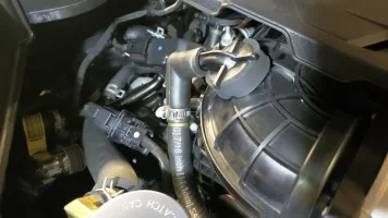

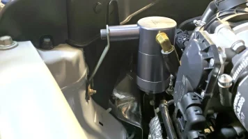

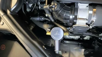

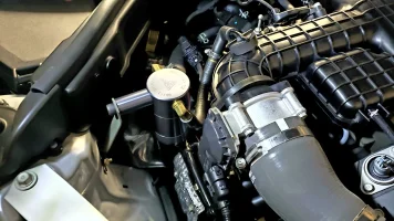

I utilized a spare Billet Technologies Hemi catch can I had sitting around. A simple bracket with nut on an existing stud, short 7/16" hose, barbed joiner and a 90deg vacuum boot is all it took.
This placement gives you enough room to unscrew the bottom of the can and get it out without spilling. It is also a 2 minute install so it can come off for dealer visits.
