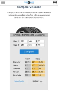

ExactlyStock tire sizes are 225/40/19 front and 255/35/19 rear. That's a 3.5" sidewall.
His new tire size is 255/35/20. That's also a 3.5" sidewall.
He didn't decrease the size of the sidewall. He increased the tire's overall diameter by an inch.
Remember, the "35" or "40" represents a percentage of the tire's width not the actual size of the sidewall. His sidewalls are 35% of 255mm instead of 40% of 225mm.
Ah, I assumed they were skinnier (optical illusion clearly). This means he's running several percent off spedo then as the madman explained.Stock tire sizes are 225/40/19 front and 255/35/19 rear. That's a 3.5" sidewall.

Probably because he stuck with the same size sidewalls, so they're oversized for the vehicle. My eyes seem to latch onto the tires awkwardly filling the wheel well.A lot of drivers on here have moved to 20" wheels. Why are Ed's suddenly looking "a tad too large"?
