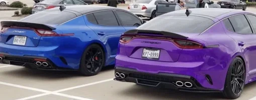

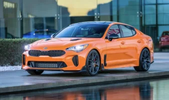

I think they look good, some lowering springs might help with the wheel gap obviously. The Stinger federation edition they were taking around to all the car shows way back was rocking TSW sprint wheels with eibach springs.
20" TSW Sprint Gloss Gunmetal Wheels
20x8.5 40mm 245/35ZR20 - 20x10 40mm 275/30ZR2023B93EE4-1754-49F9-8C72-8D2A667ABE07.jpeg
Here’s a good comparison pic I saved way back of the stock 19s vs aftermarket 20s both lowered. I was going to go with 20s but I found a good deal on barely used Michelin tires from another stinger owner and had my stock wheels powdercoated. Much cheaper overall.0399FAFD-4C26-4919-9DCE-56ABE6658209.jpeg
