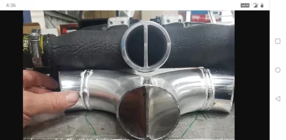

I stole the picture showing the stock Y-pipe vs Johnny Tig's Y-pipe. You can see the difference between RPM's unit at well.
I can't help but wonder if the RPM pipe could cause more turbulence vs the stock merge pipe.

Johnny Tig says
"During development we found several areas we felt required significant improvement. The first restriction is the factory merge pipe from the twin turbos. This is very restrictive and the charge air almost hits a brick wall before being joined into a single pipe to the cooler. We have engineered a significant flow advantage over the OEM merge with flow area almost being doubled."
