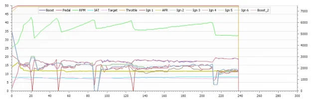

Just an hour ago, I did a test pull with a friend over a mile distance.
The car runs like a charm. I can't be happier. :thumbup:
Look for yourself :coffee:
I have absolutely no problem with JB4 and primary downpipes.
