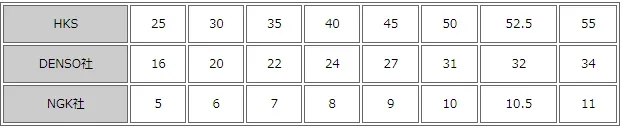

Stock plugs on the 2.0 and probably 3.3 are heat range 8.......that will translate different to other vendors but the HKS are 1 step colder @ heat range 9. The stock plugs will work, to an extent, but will require re-gap at a minimum. Cruising around town won't make much difference but at WOT, the colder plug will do better if you are running higher than stock boost. Mainly, map 2/3(1 is higher boost but in the range of the stock plugs)

Another potential issue with my current Denso plugs...I think they are the equivalent of a 35 heat range HKS, or 7 NGK which would mean this plug is 1 step HOTTER than stock...No wonder I am having issues.....already ordered a new set of HKS M45XL last night which will be going in immediately. :eek:
