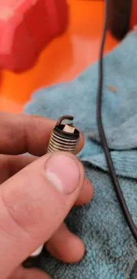

The car started running rough again and actually threw an engine code (misfire in cylinder 3). I pulled the plug out of cylinder 3 and was shocked at what I saw...
I put a whole new set of the HKS plugs in, drove it around for a bit and yet another misfire. This time in cylinder 1. Needless to say these plugs went right in the trash.
Installed Denso plugs and the car is completely different and back to normal. Use caution when opting for the HKS plugs....Overpriced crap.

You are entitled to your opinion but I have run HKS, multiple sets and although pricey, have not had one issue.....looking at this picture, it appears that plug actual hit the top of the cylinder which suggests over-torque". I could be wrong but if it did not look that way when you put it in, then very well could be over-torque......good thing is that it didn't break off in the cylinder which would have been bye-bye engine......
I always use a torque wrench....
I have no problems with my HKS.
I have changed 10+ sets of plugs without a torque wrench with no problems. Wrist tight will get you right where you need to be. I can see if I used an air ratchet lol, but I installed all 3 sets using the same method.
Not questioning your "plug tightening ac cumin"....I just prefer to use one mainly from my "working at Toyota building engines" days.....Once an hour, quality checks had to be performed and torque values of the plugs were recorded....if torque values were not within range, engine had to be pulled from assy. line.....
Just my preference.

Odd but the picture of your HKS plug looks like electrode is not centered?
