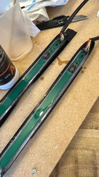

Hey all it’s been a while since my last update and the CK71’s are done. I had a bit of a pain doing them as I initially picked the wrong substance to pot the circuitry in
. I initially chose a 2 part silicone mix that in my head would work fine give a little flex and seal everything up.
However the chemistry bit me in the arse... Apparently the rubber housing of the lights poisons the catalyst and prevents the mix from curing (who knew!) Do not use the potting mix in the pictures that the stuff that didn’t work. I can give you the name and where to buy the good stuff if anyone’s interested.
So that was a mess to clean out get back to a fresh start. I then used a polyurethane 2part mix which worked a treat cured nice but remained flexible and bonded to the rubber housing.

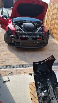

Then it was just a case of attaching them to the car. I won’t go through the wiring as there’s loads of posts about this on here but again all worked a treat.
As you can see I’ve added some big mouth air intakes in preparation for getting an induction kit. The DRL work great and the indicator shuts off the white light exactly as it should. They do look slightly DIY with the green circuit board etc something I’d definitely change if I did them again. However I’ve also put the large
front canards on which give a great look and mean you can’t see the aesthetics just the light.
Along with a full black out of the grill surrounds (apart from one corner you can see that tore
) , all other chrome and the stinger strip along the bottom of the doors I’m definitely pleased with how this has come out feel free to let me know what you guys think and I’m happy for questions or lessons learned for anyone thinking of doing this. All in the LEDs cost about £70-80 to make the
canards were another £120.
