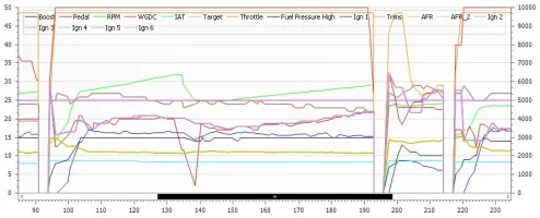

I do have a jb4 and connected it on MAP 0 just to get some logs of how the stock engine does with timing/boost. Looking through, i noticed that the stock boost reaches as high as 18 psi. at times which this is what i would expect running MAP 1???????? Trying to attach the log. if it does not attach, i will add it later.....
Any thoughts, Terry or otherwise?
It's normal same with my 2.0 stinger, 2L comes from factory with more boost then 3.3
Really?? Definitely not complaining!!! I do wonder if they re-programmed the ecu with updated timing,AFR tables among other parameters? The car never ran this "strong" with just the factory setup to include plugs.....
The 2L has a different combusion chamber design too so you get more boost and more timing. But power per liter is pretty similar to the 3.3.

No it does not...which is why i posted this for just "stock" data. It is amazing that the stock plugs with the stock gap can handle 18psi and have no issues???? Either way, will leave it stock for the time being as it runs really well and using the paddles to keep the torque in the "sweet spot" makes the 30 min drive to work enjoyable.

Great to hear you got your Stinger back!!!!!! Not only does my new engine run better but the stock boost is definitely improved. It also appears that the ECU was re-programmed and i say that because i hooked the JB4 up to it set to MAP 0 and have been running logs to see how the stock boost/plugs/timing are running and it is hitting boost levels of 18 at times and the timing appears to be adjusting accordingly. This is still on stock plugs/gap which is pretty good in my opinion......I only have K&N filter as well......

The 2.0T probably has a smaller turbo, so it'll have to pressurize the air more to move a given cfm, so comparing your boost numbers to a 3.3, while interesting, won't tell much about how your car is running. It's also only one turbo. A lot of smaller 4 cylinder turbo cars run similar peak boost stock.

Totally get the "physics" but those boost numbers that I am getting after the engine replacement are still "stock" numbers(including stock plugs/gap) and they were not that high before until I connected the JB4. Not really comparing to 3.3 just stating some information about the new engine.....it is running a lot better than when i purchased the car new......Hell, for all I know, there may have been an issue with the original engine from the start????
