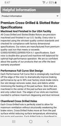

I found the "Wave" option here to be interesting: 4000 SERIES - they're not drilled, but rather dimpled [EDIT: That's incorrect - they're actually both!] - they give the appearance of drilled, without some of the potential issues. Plus they have a funky shape!
I'll happily correct my earlier statement - "there's no performance benefit to doing so on a street-driven car".
Oh, just saw the claims that the manufacturer is making. They're... "interesting". Not strictly right, but not so far removed from reality that marketing people need to feel dirty (or dirtier than normal).

I'm sceptical and looking forward to what you think she some more miles. I don't believe a pair of rotors should be $2k, but $130 for a pair seems too good to be true.
There made in China that is why there cheap.
The look like they are good quality thou, just because there made in china does not mean they wont be reliable and work just as good as oem.
They're all made in China
These rotors are legit.

Machined and finished in USA is different than manufactured in USA. Almost 100% of aftermarket drums and rotors come out of China now. All brands, sub-brands. Same factories.
Roflol! It's a piece of metal. As long as it meets or exceeds specs, I couldn't care less where it was made.
You are 100% correct.
I guess I can say this now since I no longer work for Brake Parts.
What Brake manufacturers do is manufacture most/if not all in China or buy it from a manufacturer from China. They then add some steps in USA such as packing, machining etc..... To market it made in USA.
There has always been this impression that Chinese made stuff is Shit. That's is not the case, at least with brake parts sold from legit companies.
The manufacturing facility that Brake part has in China is top of the line. All the latest robot's and equipment. All the engineering design, testing, packaging, and machining for high performance rotors was done in the USA. In the box we didn't put made in China, we put engineered in the USA. Its all a marketing strategy, but I can argue that the quality is no different than made in the USA. It just all about cost savings. We even sold rotors and pads to Brembo that they repackaged into their own.
