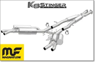

I am interested in this exhaust option - it seems to work on the principal of a chamber to cancel harmonics (I've seen it before, I can't recall the name) to kill drone.
Magnaflow does it
Ark does it
Looks like Jun does it too, a little hard to tell here
The Jun option seems to have an exhaust tip coming out of each chamber. I believe they use the larger chamber primarily, with the smaller chamber only opened up when required.
Edit: I think you have the wrong pic for Jun - I see on the K8 Stinger Store they have one with the Helmholtz chamber (I went and looked it up). :)
The Magnaflow option looks interesting...

Yeah, I have that attached too, they have a resonator on the 2.0 exhaust, but it's different on the 3.3
