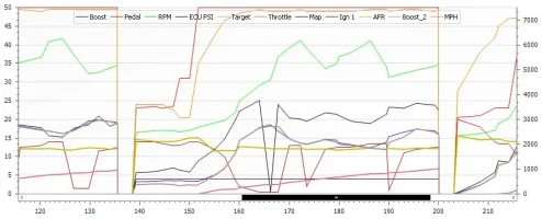

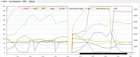

I did 4 beast mode brake snip tests this morning. 1,2,4 where on map 0 with different amounts of throttle. 1, 2 didn't cut throttle, 4 was a tire smoker and throttle cut. All 4 tests were slower than LC. Looks like 2 issues. Timing cuts to deal with high boost and shortly after high pressure fuel drops to 5 (I assume 5 is bad? - 10-11 looks normal) and then throttle cuts. So looks like a combo of over boost and fuel pressure.
Run 3 was Map 4 valet mode. Big timing drops to keep the boost in check and thought I heard some blow off during brake boost.
I guess I do need to dial back my 1st gear just a bit as even during normal runs I get a slight timing dip during that 22 PSI spike.
Here is run 3 valet mode and the most aggressive map 0 launch.
Thanks. Looking at map 4 seems like the lowest we can get boost in 1st gear here is that ~19psi peak. Not really low enough to do do what we want. Lowering boost in the flash either in just 1st gear or across the board would probably be a good move.
On fuel pressure dropping looks like it was just making a lot more power there. If it's a trend then may need to lean out air/fuel ratio in that range or at least lower boost.
What kind of fuel pressure number do you consider bad when running high E content like over E30?
I'll try to get 1st gear boost lowered.
Normally around 5 is where we'd cut boost if it stayed there for more than a second or two.
