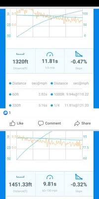

@TorkMe hits a 121 summer time dragy trap and 9 second 60-130 on 92 octane, no e85, no wmi. Not bad.

Hoping to match or beat Angels time tomorrow with a .15 slower 60 foot. With a full power snip I'm 11.5s no wmi.
