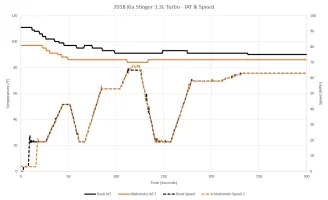

Regarding IATs being higher than stock during low-speed cruising/around town: we wanted to test this impericaly, so we bolted our Stinger up to Dynapacks. We're able to program the Dynapacks to control the hub speed and engine load to simulate different driving situations; so for this test we programmed the Dynapacks to run through a series of low speed pulls and short low-speed steady-state sections. We also set our dyno fan to a lower speed to simulate the lower airflow of around-town driving. After letting the engine idle up to operating temp, we ran this test for 5 minutes with both the stock intercooler and pipe kit and the Mishimoto kit, ending with a pull to highway speed. We logged the intake air temp via OBD and found that intake temps were lower than stock throughout the test.
It's also important to think about what effect any increase in IATs has during this type of driving. The probability of dangerous knock occurring during low speed/off-boost driving is extremely low. If you are experiencing knock in these load ranges, there's likely a bigger issue than a 10 °F rise in intake air temps. More importantly, when you're only using 100 lb-ft of torque to keep the vehicle at speed or start it moving, the effect of that rise in temp is imperceivable. As soon as you put your foot down, the pre-heated air is replaced by fresh cool air and IAT drops. I personally see this effect every day with my GTI (granted it's nowhere near the output of the Stinger) - cruising around town and in traffic, intake temps usually sit about 40-60 degrees above ambient, enough to be considered dangerous if the engine was under load or producing boost. The ECU may be pulling timing and reducing output during these times, but since I'm using so little power to move the vehicle, it's not noticeable. If I then go from a 5 mph roll with temps 40 °F over ambient to wide-open throttle, the intake temp drops to just over 10 °F over ambient by the time I build boost and the ECU does not need to pull timing.
Hopefully this helps clear up some of the concerns about IATs during around town driving. Feel free to let us know if you have any other questions.

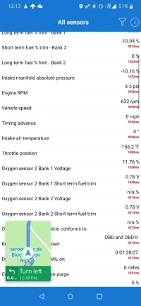

Screenshot_20201105-121328.webpthere is an improvement in airflow, the boost builds much faster. However the engine does get pretty hot and that effects everything under the hood. After about 2 pulls the iat was about 170 degrees... Hello pulled timing. Just another reason to install that meth kit I have sitting around.

No e30 yet, but thinking about it. Looking into the sensors available. In summary yeah, I think it's worth it if your running the stock fmic. The boost builds much faster but all the does for me is just make me loose traction that much quicker lol. Tractionally challenged life with rwd. I might do some sort of heat coating later on. Well for 1.2k it's not that bad of a purchase, since now I have 2 core units since one came damaged. Guess that's the other thing Mish got going for it, the lifetime warranty
