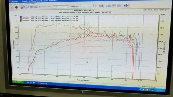

If it matters, I dyno my G80 sport 3.3tt AWD last week, they ran 3 pulls....
1st. Map 0 - JB4 disable
2nd. Map 1
3rd. Map 2
I only changed the spark plugs to Denso 5346 and car runs on 93 octane.
Looks like tires bouncing on the dyno effecting the reading, seems to be common on AWD dynojets if not properly strapped down. Average gains look good though.
Yeah, we talked about it, hence I'm getting new wheels and tires this Saturday, can't go wrong with PS4S ;)
Dareck lookin good! Holy crap ,no wonder my car pulls hard on map 3....lol put your beast on map3 and hold on :) Wash
