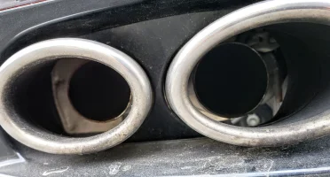

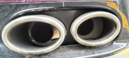

I have OBX racing downpipes and the mbrp exhaust not stock exhaust. It is possible the right side tips might be touching the inner fakies they're not equal from side to side the right side is in word on the tips not centered like the left side is not sure what's causing that whether it was the mbrp exhaust or from the OBX.

Ok. The tips should be evenly spaced. My guess is that something is touching or your exhaust brackets are loose. Have any leaks?
No leaks but I'm going to get up underneath there, I'll take some pictures
Something's rattling but nothing is touching so it must be the fascia or something super annoying. As you can see the right one is not centered, a center rod would have been nice for that adjustment. My biggest fear is that there is a defect in one of the muffler's internally.
