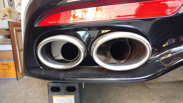

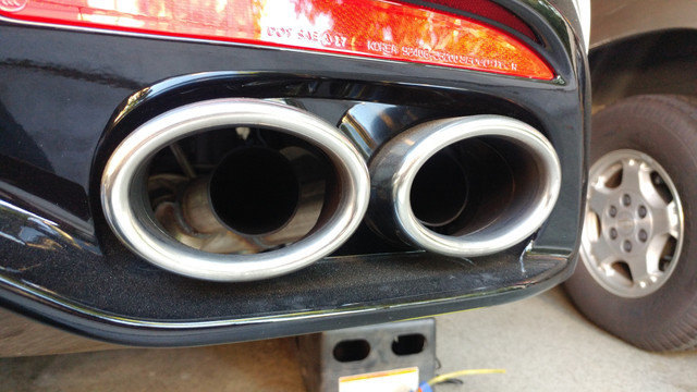

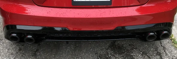

Just some pics of the exhaust "tips" behind the fascia. They're painted with black primer (though one of them is already flaking off a bit), and are quite a bit off center (more on that later):

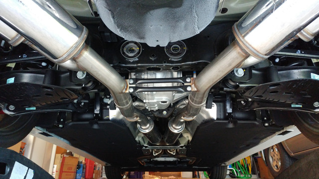

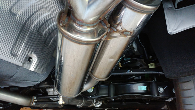

Here are pics of the mufflers and attached Helmholtz resonators. You can see dents on the passenger side, and the driver's side one looks nice and new thanks to hottexhaust.com replacing it as it had a big dent in it that couldn't obviously be caused by installation:

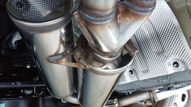

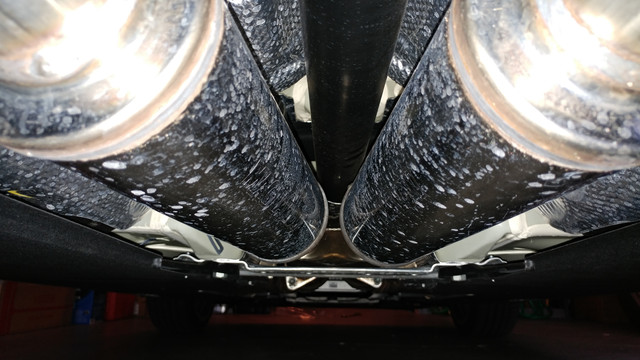

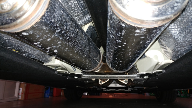

Here are shots of the resonators just after the X-pipe. Note that there is VERY little clearance with the bracing bracket (1/4" at best), and that the exhaust is NOT centered. You can see how the driveshaft is off-center in comparison:

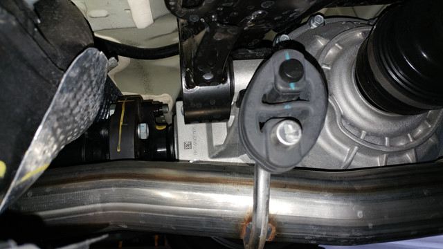

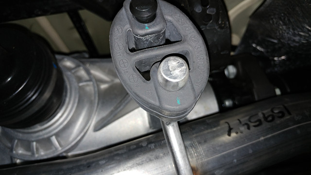

And finally the overall fitment indicated by the first set of exhaust hangers. I loosened and tried to realign everything multiple times, and without actually modifying the exhaust system itself to correct for this (bend/rewelding hangers, cutting off pipe/flanges to change lengths), it just doesn't hang right on its own. I chose to take the win where I could and adjusted the mufflers at the slip joint to ensure the muffler hangers are hanging perfectly vertical.

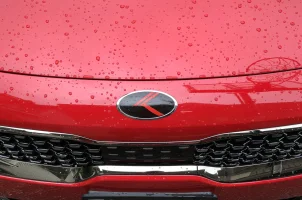

But wait, there's more! I really hated that cheesy "mf" plate, and thanks to my buddy at his work, he made some bars per my measurements to place across. I then painted them in black primer and clear coat.

I've had the exhaust on for well over 500 miles to allow for break-in (including some extra WOT runs to purposely "blow out" the glass pack as much as possible surrounding the steel wool). It's volume has increased since first installation, and it sounds more balanced with a slightly more aggressive overall tone. However, the medium engine load resonance is still there while full throttle lacks the roar it really deserves. The fitment isn't quite perfect, and it takes some physical modifications to get right: simply loosening everything and reshifting/repositioning isn't quite enough and some part of the exhaust system remains in "tension" otherwise. It does come with a butt dyno improvement, something I'm confident enough in telling someone to dyno test to corroborate. How much gains the butt dyno can never accurately tell, but there is definitely something opened up towards the upper RPMs at the cost of shifting the torque band a bit. If you're into a more "executive express" exhaust rather than "hi I'm loud", this is the exhaust for you. It's not perfect by any means, but presents an alternative to trying to make the Stinger sound like its engine means business out the back end by giving a more subtle and classier "sporty" sound to your tailgaters.
Excellent review ZyroXZ2. I just installed the Magnaflow last Friday. Took just under 40 minutes and the fit and finish is of good quality. Every thing lined up where it was supposed to. I never liked the factory chrome tips so I replaced them with carbon fiber units. That took a couple of hours to make fit. Very careful plastic removal around the existing bumper holes using a dremel cutting wheel and razor blade was used. Sound is what I expected. A nice and deep rumble without any drone. Just enough noise under load to differentiate from stock. Power increase is definitely noticeable. From 3500 rpm to redline it pulls much harder and allows the turbo to spool up quicker. The increase is helped by the additional addons I have on the car. RaceChip Black with the upgraded more aggressive race mode, XLR throttle controller, K&N drop in filters, gapped stock spark plugs .024 and using 94 octane fuel. For fun I created a vinyl over lay for the front and steering wheel emblem. The only other upgrade I plan to do in the future is to replaceimage1(1).webp image1(2).webp image1.webp image2(1).webp image2.webp the intercooler. I have Eibach's installed and am waiting on my 20" rims to arrive. I will post additional pics once the new wheels are installed. View attachment 9058 View attachment 9059 View attachment 9060 View attachment 9061 View attachment 9063
Those CF tips look great. I was thinking of doing the same thing. What size Did you use, and is it 4 single tips? What size and how did you attach them? Did you just make a bracket and screw into the valance like OEM, or are the connected to the pipes? Did you just enlarge each hole in the valance, or did you cut a big oval out? Where did you get the tips?
Excellent review ZyroXZ2. I just installed the Magnaflow last Friday. Took just under 40 minutes and the fit and finish is of good quality. Every thing lined up where it was supposed to. I never liked the factory chrome tips so I replaced them with carbon fiber units. That took a couple of hours to make fit. Very careful plastic removal around the existing bumper holes using a dremel cutting wheel and razor blade was used. Sound is what I expected. A nice and deep rumble without any drone. Just enough noise under load to differentiate from stock. Power increase is definitely noticeable. From 3500 rpm to redline it pulls much harder and allows the turbo to spool up quicker. The increase is helped by the additional addons I have on the car. RaceChip Black with the upgraded more aggressive race mode, XLR throttle controller, K&N drop in filters, gapped stock spark plugs .024 and using 94 octane fuel. For fun I created a vinyl over lay for the front and steering wheel emblem. The only other upgrade I plan to do in the future is to replaceView attachment 9064 View attachment 9065 View attachment 9066 View attachment 9067 View attachment 9068 the intercooler. I have Eibach's installed and am waiting on my 20" rims to arrive. I will post additional pics once the new wheels are installed. View attachment 9058 View attachment 9059 View attachment 9060 View attachment 9061 View attachment 9063
*GASP* You covered the Kia logo :cry:
Also, hmmm... My mufflers WERE both damaged in transit, that makes me wonder if more than that was damaged during shipping if yours fits perfectly. o_O
I didn't inspect my rubber hangars closely, but I didn't have any fitment issues at all. Everything seems centered and sounds great. I kinda like the MF plate. It's subtle enough that most people won't notice it anyway. I totally agree with your assessment of the tips being too visible. I may get some high temp black spray paint and paint all the way back to the canister.
Part of me is worried that people will think I think I'm some "badass mf"... The mufflers both already have the full logo in it, I think it's a bit overboard o_O That, and the plate is horribly un-aerodynamic :laugh:
