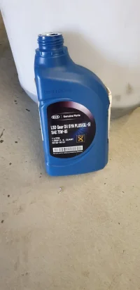

Take it back ASAP, this is what they should have put in it.
UPDATE: dealership confirmed it was the diff oil causing the vibration. They replaced it with the upgraded oil as per TSB. They confirmed that they put the standard oil in during my recent 40K service as not all Stinger are affected by this issue.
It's smooth as now. No vibration at all. Thanks to this forum, otherwise i probably wouldn't have taken the car in to get checked.

Doesn't bother me much as I grew up with Muscle cars that always had LSD's. I suspect all they add is a friction modifier into the diff to help the clutch packs slip a little easier, allowing the inside axel to slip (I did this for my Mustang).

The TSB is quite vague in that it doesn't specify certain VIN/build date it applies to or whether it's applicable to all.
Surely Kia would keep records of what fluids are being used at the production lines...?
I'm guessing the friction modified implies 'full synthetic' meaning it performs better and more importantly lasts much longer.
The regular one may function well until a certain mileage - this is then wear n tear will start to occur.

Job should take no more 30-40 minutes.
