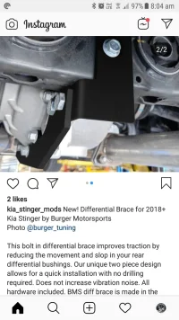

Diff brace anyone?
@Terry@BMS
So this should help distribute the power to each wheel more evenly when accelerating while turning? My differential was completely replaced & Kia said its operating properly, but I still get wheel-hop and more power to my left rear tire, especially on turns. Will this help prevent that?
Also, will this be considered modifying the differential, or have any effects on Warranty work?
@Terry@BMS
Just as a suggestion you could change the sub frame bolts and put in the sleeves as i have heard in ca n help with the hopping. My sway bars have alleviated alot of the hopping too when turning.
Thanks for the suggestion and looking for anything that may help. Possibly a stupid question, but what "sleeves" and sub frame bolts are you referencing?
