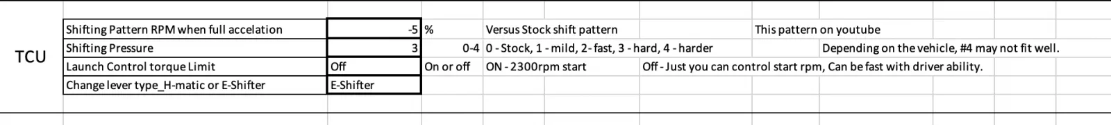

So is this in the ECU tune, the TCU tune, or both? Are there any options forthe TCU tune in terms of torque limits?
I have a jb4, and I like being able to mix E30 sometimes, other times just run straight CA91 when I can't find E85 - just switch the wiper switch down from map 3 to map 2. It seems like with the ECU 1.5 bar map, I'd always need E30 based on previous comments? That's a no-go.
I'd love to be able to launch with a bit of boost (otherwise it takes a bit to catch some silly cars that think they can hang), faster shifts. I don't want 500+ lb-ft in 1st or 2nd - I'm worried it would destroy the center diff with that hard of a launch (I'm AWD).

If anyone in a GT2 or G70 (e-shifter cars) wants a TCU I have one for sale. I bought it from Dave on the forums and didn't realize it probably won't work on my GTS with the manual H-matic shifter. Pm me
