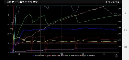

Was working with Williams at first to figure out kinks of tune of course haven't seen anyone else running a 1.7 bar so nothing to compare to
Shifts are quick but a lil harsh especially on downshift.

Logs look good. Does it Rev match hard? Why's downshift harsh? How was launching it?
I haven't launched it but did do a mean burn out
I believe it's do to raising the line pressure
