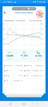

On my official run I'm stripping all seats besides drivers and getting new rims and ps4s will shed 73 lbs rotational weight and 160 extra lbs of static weight
I’m looking forward to seeing the slips. It’s going to be glorious.
