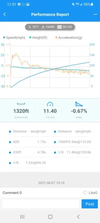

The tcu tune just came in yesterday it did seem to help with the ecu timing a little bit as well. I would say that I am pretty happy with the tcu tune. I went with 5% and it does still peak just over 6k in some gears which is above the best power band. The awd tune I was sent was the wrong one so I cannot comment on its performance. Previous best 1/4 time on factory tcu was 11.59Screenshot_20210607-235130_dragy.jpg
Is that on 91 or 93 pump?
@Williamsj41 - Wow, you are really movin' - very nice! Did you spin on launch?
@turboAWD - Yes, the awd tune transfers power to the front faster to maintain traction. TCU works with JB4 - See post from bhamm above.
Yes this things moves and alot of spin in an awd. It even can roast the rear tires trying to launch control and the fronts won't move. That was my first pass without fine tuning 3/4 tank of gas all season tires and no weight reduction.
Well, after just the first pass you're certainly going to go faster. I can see in the Dragy you aren't pulling as much Gs on launch, so with more grip I'm excited to see your time but also scared for your transmission!
Me to I hope it holds I will have to run it soon after I get a few more parts in on the build.
