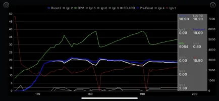

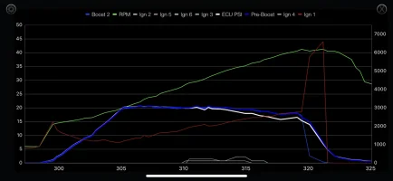

This is two 1/4 runs log that used JB4 map6 to add 0.5-2psi for 4500rpm and above. I’m wondering if this much timing pull is acceptable.
Maybe someone else can chime in here but for whatever reason most cars running a tune and WMI have elevated timing deviations on IGN3. Again not sure why but I have seen the same thing, IGN2 and 4-6 are all at 0 and IGN3 is 2+ degrees
Funny mine is opposite 4&6 are the 2 cylinders that always show up with some knock retard in my logs. I can do a battery reset they will disappear then come back. 4 being the worst
Yup. That’s what I see too. After reseting the ECU this is what the new log looks like. I’ll switch to a larger nozzle soon and let see if that makes any difference.
