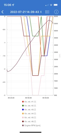

F98CEBAD-9D5B-46A4-B74B-DC8145982CAA.png7AC20EB5-DAE5-40F0-AC66-691EBBD11FD8.pngGot revised with 1.5 bar tune without boost ready. Surprisingly less timing pull with shell 93 so I’m confident that WMI can clean it all.

This is the timing pull before.
What do you use to log?
