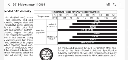

Pennzoil Platinum Euro 5w-40. When I was using 5w-30 (before Lozic ECU) I noticed the oil would creep down the dipstick throughout the oils life. I changed to 5w-40 about 10K ago and the oil consumption disappeared until I upgraded my primary downpipes.What kind of oil are you running? More specifically, what thickness? 30 or 40?
How and where could they? Kia run diagnostics to look for logged max boost and like rev what I understand and with a stock ECU it cant have been logged.They deff can even with stock ecu put back in
Oh Good, That the exact oil I was going to suggest trying if you where not on it. The 20w40 probably wouldn't hurt to at least try it.Pennzoil Platinum Euro 5w-40. When I was using 5w-30 (before Lozic ECU) I noticed the oil would creep down the dipstick throughout the oils life. I changed to 5w-40 about 10K ago and the oil consumption disappeared until I upgraded my primary downpipes.
I mentioned 20w-50 to Lozic and he said I can give it a try. I asked him about 20w-50 because in the 18MY Stinger Kia recommend it. I wonder why they changed their switched their recommendations?
UPS has no record of anything under my tracking number Lozic provided me, so I guess I’ll reach out to him and see if he knows what’s going on.Sign up for ups delivery manager ups probably has it.
You mean 20w50? Valvoline makes a 20w50 full synthetic API SP rating. That's the one I'm eyeing. But I'm also worried about oil pump strain and the CVVT hydraulic system not liking such a thick oil. I really would like to hear from a Kia engineer why they changed their recommendations. Any Kia engineers on here? lolOh Good, That the exact oil I was going to suggest trying if you where not on it. The 20w40 probably wouldn't hurt to at least try it.
Probably not in this thread at least lolYou mean 20w50? Valvoline makes a 20w50 full synthetic API SP rating. That's the one I'm eyeing. But I'm also worried about oil pump strain and the CVVT hydraulic system not liking such a thick oil. I really would like to hear from a Kia engineer why they changed their recommendations. Any Kia engineers on here? lol
I guess I'll give the 20w50 a try since Lozic gave the green light. Also it's summer time and according to Kia's original recommendations 20w50 is gtg.Probably not in this thread at least lol
