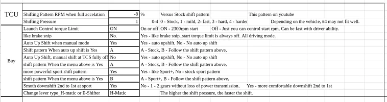

I just sent in my order form. I was sent a new order form from Lozic just a little bit ago and there are now new setting options regarding the TCU. Also he is working on a website for the states and it will be up soon.1652061923116.webp
I just sent in my order form. I was sent a new order form from Lozic just a little bit ago and there are now new setting options regarding the TCU. Also he is working on a website for the states and it will be up soon.View attachment 70648
Torque limit on? You don’t see that very often!
Yeah, I'm a little conservative when it comes to the TCU settings as I am aware of the weaknesses regarding the transmission.
I do like the additional options he has added on the TCU order form. You did pressure 1 like me- but said yes to the sport being more like sport+ I went No on that one.
Curious, what weaknesses have been discovered with our transmissions? I haven't heard of any failures outside of high mileage cars. Even the guy running 10s in the quarter didn't have any driveline issues from my understanding. I know they aren't quite as good as the ZF transmissions but they seem decently reliable.
