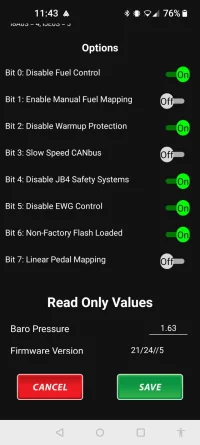

I have no idea I order 1.5bar,boost ready option D, and I told him I use wmi for track day. Maybe a boost senor bad I don't know I think he said boost might vary depends on mods
Huh interesting, maybe because you told him you use Wmi the mapping is different. Or maybe something totally different. Out of curiosity do you use a JB4 to control your wmi? If so maybe the boost is backed off due to the fact that the JB4 will bump up boost when the meth is sprayed. At least that's how I think it works. I'm still in the learning phase of tuning.

Sorry to hear you are having so much trouble. I guess the factory mapping is different for the 22s.
I would be very frustrated if I had to pay for a remap 3 times. Especially if it never was right in the first place. I probably would've given up on the 2nd remap and requested a partial refund.
Hearing stories like this makes me hesitant to upgrade to a 22' Stinger...
I have my 22 stinger tuned by lozic and I got the overboost problem due to the missing sport+ mode triggered the torque monitor crashed once. Lozic shipped me the new ecu with 2022 file on it right away and it’s been stable since then and survived launching during Canadian winter without overboost. He’s also dealing with UVO problem now and hopefully I can get my UVO back soon and I would like to revise the tune from 1.3 bar to 1.4 bar too.
