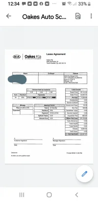

I'm just wondering if I get the down payment subtracted from the final payoff amount at the time that I buy out the lease. If so, it doesnt matter where he puts the rebate. But if it is NOT and I lose part or all of that rebate money, then I have to insist that he take the rebate off the adjusted cap cost. Is that clear as mud? I hope I have made some sense at least lol
you should be ok so long as they add the rebate/down payment to the cap cost reduction section. I know you mentioned your adjusted cap cost went up though which makes me think something is off. Do you have a worksheet you can share?
Yes, here it is. But the discount is not enough so we will be passing on this one. I really wanted to make sure that I understood the numbers and the process.

Yeah I would pass on this as well. Does looks like the rebate was taking off the adjusted cap cost though. But you mentioned wanting an AWD and based on the msrp it looks like they quoted you for a rwd gt2. I think awd closer to 53-54k msrp. I got mine towards the end of the month they might be more willing to negotiate in a couple of weeks. Good luck!
Thank you so much for the review and we agree! We did know this was for a RWD and may have considered it if the price was right. The hunt continues! but at least we are feeling more confident about our grasp of the numbers! Thanks again!!
Good call on passing on this deal. My numbers tell me your Adjusted Cap Cost would need to be at $38,648. You would've overpaid by $3k with an Adjusted Cap Cost of $41,625.
