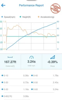

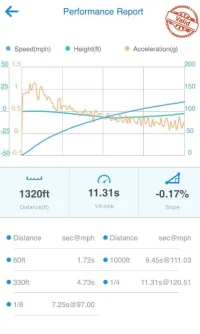

Anyways this is the same ECU tune stage 2.5 with meth. No race gas just e30 mix. Dragy verified
Despite all the haters on this thread, Numbers don't lie.
The car is absolutely flying, and it's only running 17-20PSI. Now that's impressive.

Just wrote a review myself.
Another successful track night at Capital RaceWay
Huge shout-out to LAP3 for always providing the best and only the best
Ran 11.07 @126.19 and that's moving in my books on top of the slight heat soak we got while staging.
Mods list LAP3 Stage 2.5/Stage 3 TCU
AEM intakes, Lap3 meth kit, Borla catback, NGT catless primarys, Stock secondary's, eibach springs, 4.85 gallons of e85 and rest 93.
Pass seat removed only, rear seats were kept on and with stock hood/battery.
If this isn't proof enough idk what to tell you. I daily my car and drive it everywhere I go. I don't switch or change anything out except for my pass seat which I remove for the track. I drive in sport mode most of the time and the ecu/tcu combo is smooth. I didn't buy or build this car simply for the track, I bought it to be fast when I want to and still daily drive it without any issues. Next track night I'm gonna be fully gutted probably and shoot for high 10s which is definitely doable seeing what I can do with almost full weight.
