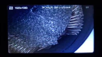

NGT also used 200 cell prior to changing to 400 cell. I have their a set of their 200 cell. The passenger side was actually replaced under warranty. It got clogged and collapsed. I might buy a set of 400 cell to help prevent this from happening again.

One person made a good case concerning exhaust restrictions. The small manifold going from the heads to the turbos can't remove the exhaust gases fast enough. Cramming more in the engine with no where for it to go (hybrid turbos). Back pressure builds and temps climb. Making for a bad situation.
