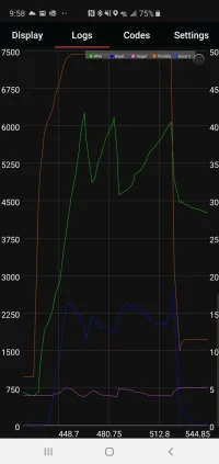

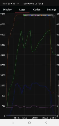

Throttle is used to regulate boost, boost tapers at redline, so you should see throttle movement during shifts especially on lower maps. Look at psi vs psi2 to see how much trimming is taking place (not throttle position that won't tell you).

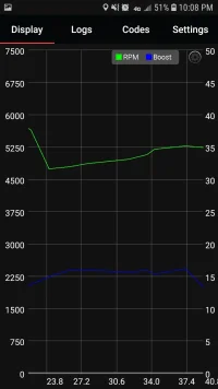

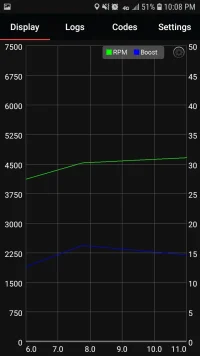

Dont know which thread to post on but was wondering how much psi are u getting on map 2 with 93 octane... i have GFB respons BOV and wonder if it affects psi and should try to tune em better.. im getting 15 psi occasionally 16 psi (canadian gas)
Ok sounds right.. my logs run only on WOT and theesr are a few randoms

The good news is that I don't hear the rocks in a can sound anymore.And I've determined that the sounds didn't actually come from the JB4 sliding (like I originally thought). Perhaps it was legitimately knock. All I know is, either the JB4 or the car corrected itself and I no longer hear the sound. My logs also don't look bad either. Well, minus the throttle drop almost every time I shift from first to second under WOT.
@Terry@BMS, while I feel much better about running Map 2, I'm still curious about psi2/boost2 and what you meant by "adaption" (see my previous post). Any help on understanding those two things would be greatly appreciated![]()
