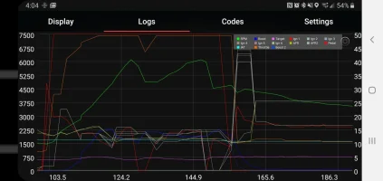

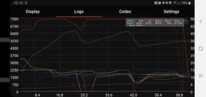

I'm getting about the same, but it's not even a sustained 15psi. It tapers off pretty quick. At highway speeds I only get between 13 and 15 psi. I only have a day's worth of logs though so this could change over time. I've attached two snapshots so you can see my boost over a few 0-60 pulls.

Ok sounds right.. my logs run only on WOT and theesr are a few randoms
