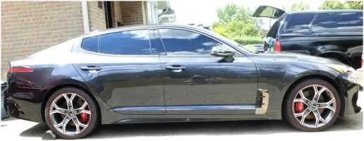

This is how I did it:
Because the material comes coiled up, I wanted to straighten and relax it first.
For 19” wheels, I cut 4 pieces of 165cm/65” length.
Taped the pieces to some suitable wood trim pieces with blue painter’s tape.
Put it in a warm place for a few days, until considered ready for installation.
When ready I wiped the rims with isopropyl alcohol and followed that with a wipe of 3M Adhesion Promoter #06396. I got a box of this stuff from an automotive supply house. Maybe a body shop will sell a couple of pouches. One pouch should suffice, two is plenty.
I started by undercutting the starting end at an angle.
Then observing and following the machining ridges on the rim, I touched down the end and continued by pressing the remaining material without stretching it onto the rim following the same ridge on the rim previously selected.
I found it convenient to apply the rim protector counter-clockwise.
When I reached the starting point I eased up on sticking down and measured to the opposite end, cutting it about 1mmm / 1/32” longer maintaining the same angle.
I then lifted the loose end under the starting end and massage the material down onto the rim.
I had a metal roller handy, which I used pressing down on the material, avoiding any stretch, following up with a rub down using a microfiber cloth.
